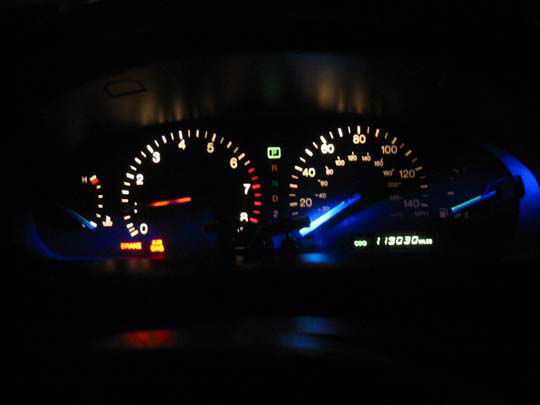

Or you can try extra super bootleg version that i did <_< . My g/f didn't trust my soldering skillz so she opted to put LED lights inside :chairshot: . It looks ok... but like i said before... real bootleg compared to the KRUDGE FIX. We glued some Craft Lanyard... it's not string's but the thin thin colored PCV plastic. It's like a string but a thin PCV string. Hard to explain. We chose NEON GREEN. Wit the LED blue lights on the NEON Green... it makes it bright.
This is how it looks like... my bootleg way. But if u do the Krudge Fix... i promise u it will look better than mine. If only she let me solder. :rolleyes: Hehehehe.

yes sir it indeed is me :lol: Hahahaha... you recognized the cluster right? Thanks for ALL the help you have given me DC. It came out ok, not going to complain. Compared to having all the needles BLACK. I guess i'll work more on balancing the needle this weekend... or whenever my g/f wants me to.
