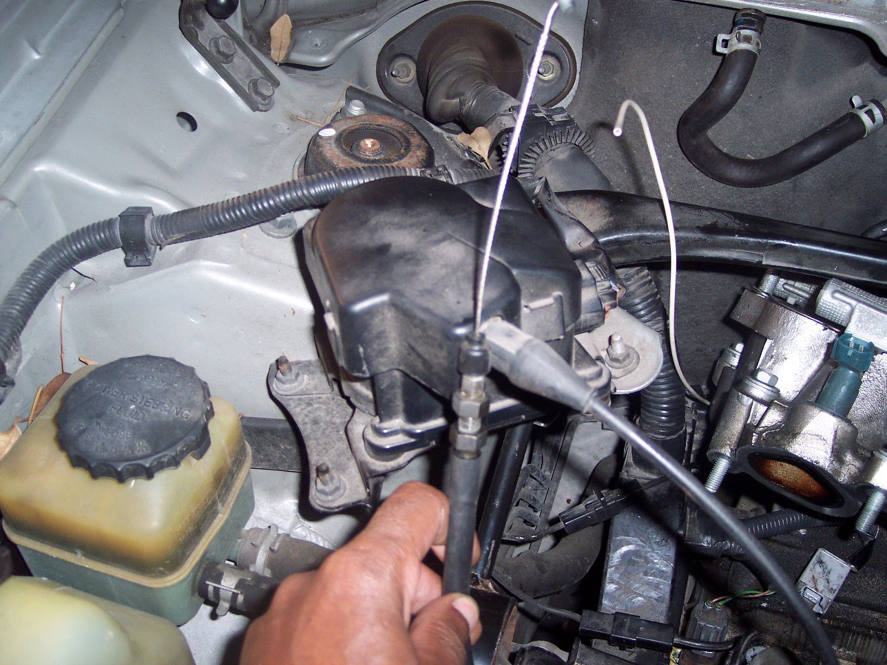

i am also attaching two photos of a cable that has come apart. it seemed to stretch the entire length of the engine compartment--can't remember where it ends. photo is of the source and the apparant disconnected end. happen to know where it goes?post-108949-1263988077_thumb.jpg
