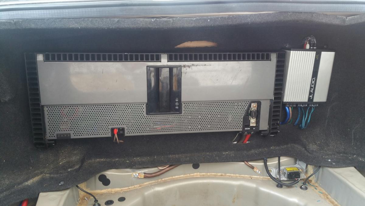

Here is my amp rack I had made. I also have sent back my subs this Fosgate amp blew them but I am having them upgraded.
post-158382-0-30309600-1446953861_thumb.
I wish I could be in on some of these installs and mods. I could figure out how to do it with out adding a single new hole on the car, or goofing anything up on the car to do it. One exception would be the console box like in the Lexus dealer phone install.
There is always a way to build some kind of bracket or use some existing hole to accomplish the task.

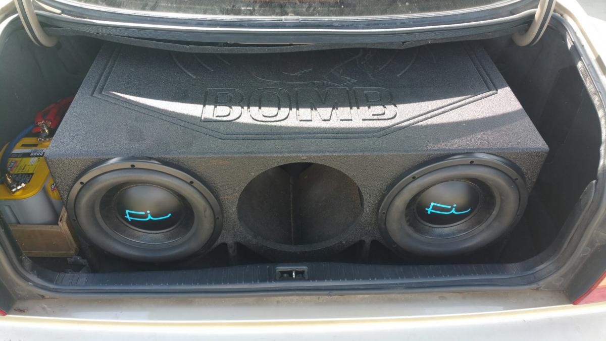

How often does one get to say this with a straight face... "Nice rack!" ^_^
Hahaha thanks for the compliment. It's nothing fancy but it's a nice clean setup. We could have probably mounted it without drilling any holes but it would have required more fabrication brackets/wood and I'm not too sure I would have had the clearance for the box. It fit in there perfectly and have about 6 inches of clearance for excursion although these subs don't move that far and I have about 4 inches of clearance on the back side to let the amps breathe.
