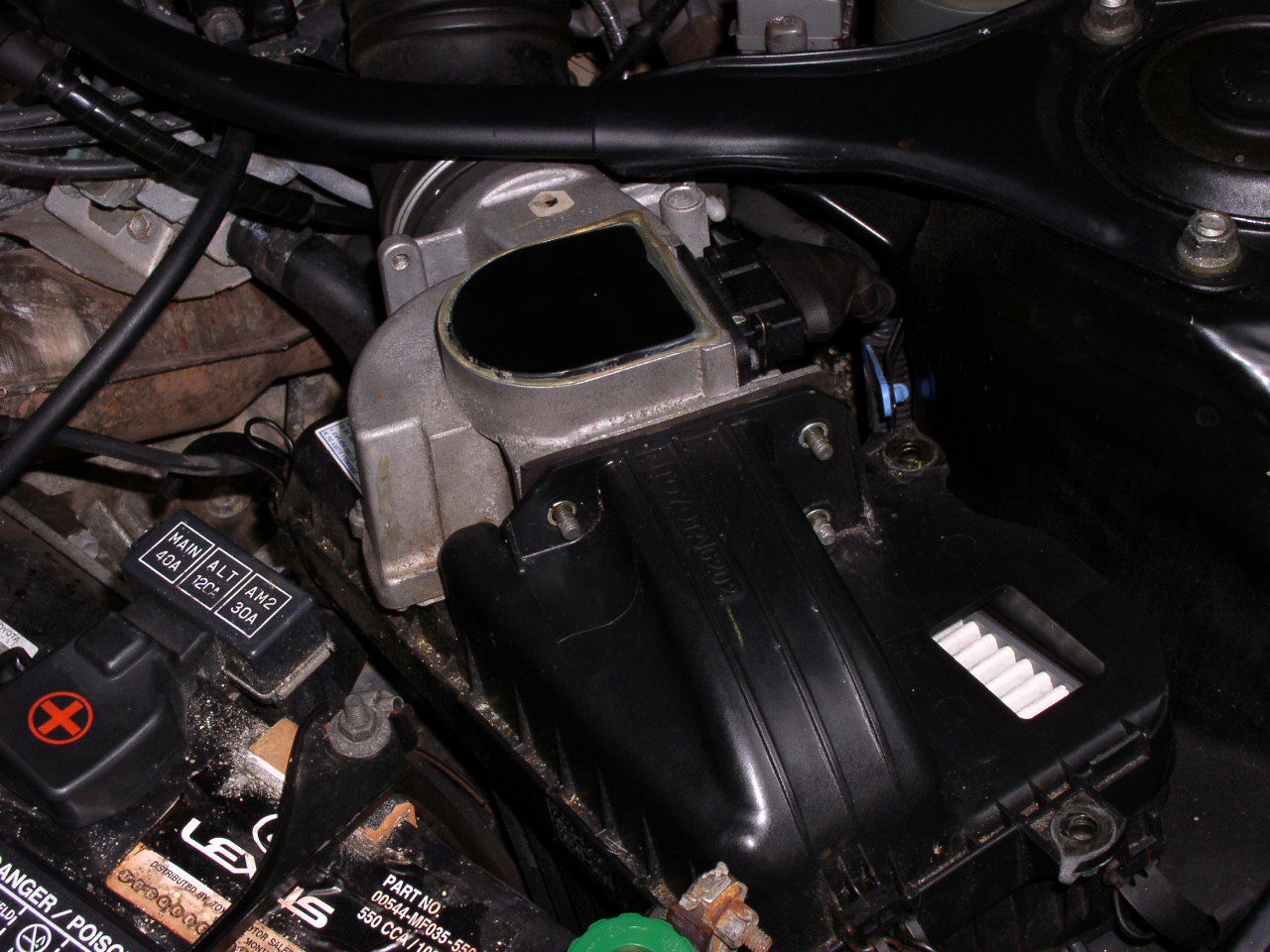

Yeah it's a mix of city and highway, but when Toysrme says that I have a nearly 16 gallon tank, either my low fuel warning is too conservative, or my gauge is really off.
TCK, despite all your tutorials and pictures, I am still at a loss. My engine bay is somewhat different than yours, proving to be a little more difficult to work with. Here's a few pictures to help you out. It's a 2VZ-FE.
This is how I currently run my air box. The muffler is off, used to cover where that small hole is, I found that once I'm up into the 4000's in RPM, I get a little more pick-up.

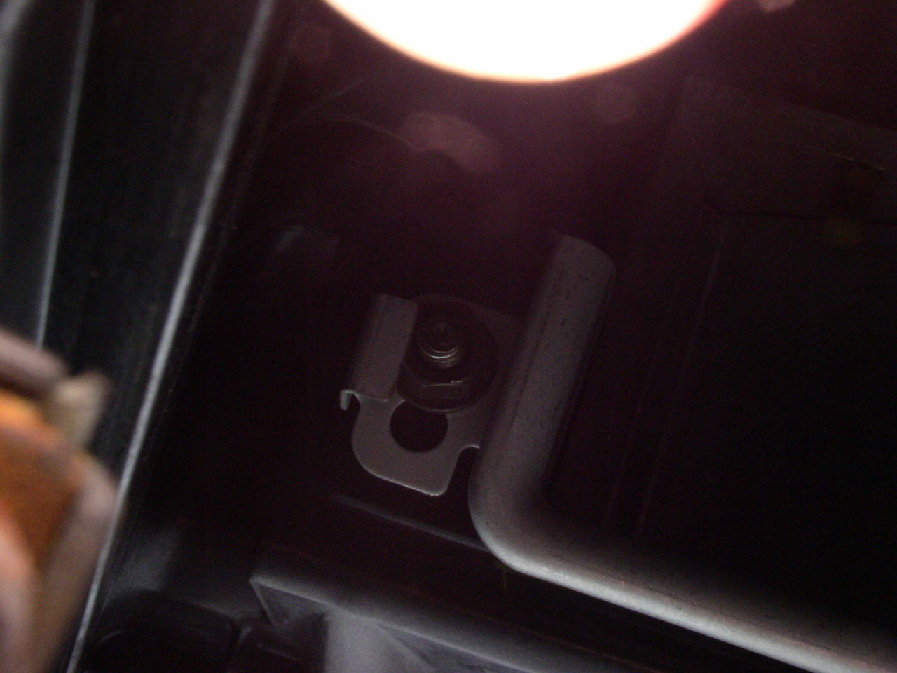

This is the 4th bolt I am talking about when it comes to removing the air box from the AFM; still can't find a way to get it off, and I had enough trouble pulling up the airbox enough to get this picture!

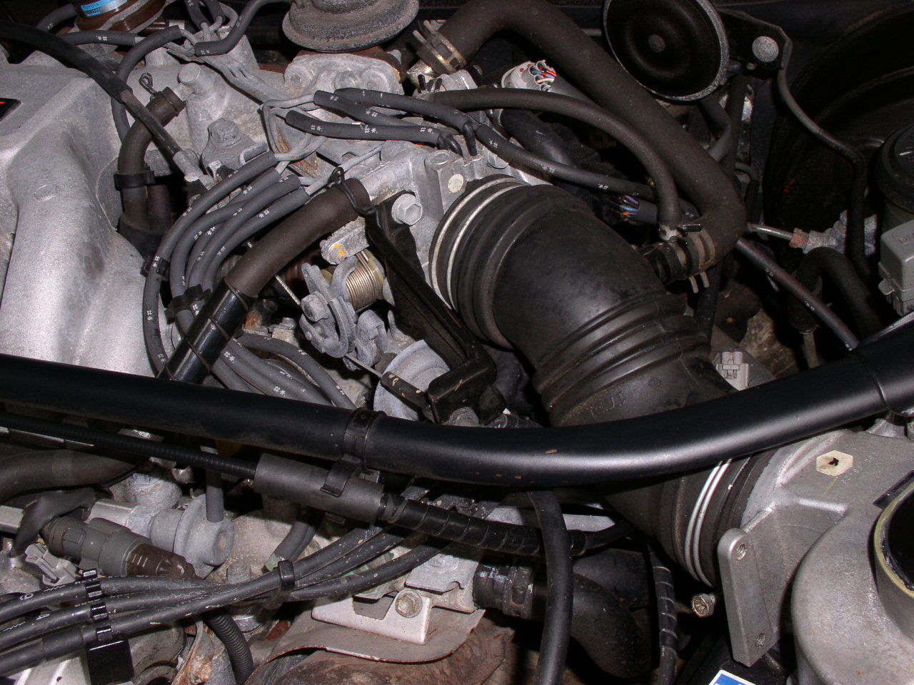

Here's my air intake, almost exactly like yours, but the engine does not reach up close to it, and I cannot see where the distributor is.

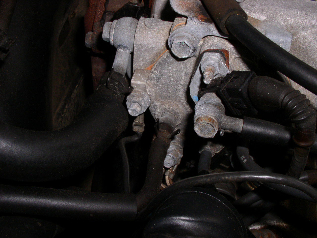

Same thing with my PCV valve, although I think I might have found it; (the hose with the pinch clamp, the farther right of the 2). I have decided to hold off with the parts from Autozone as you suggested, and will take a trip to the Lexus/Toyota dealer soon.
Ain't photography wonderful?
Your basic layout is a lot like mine, just a little more "cramped", less room to move things around. Components are in basically the same place.
I have one question for you - why are you removing the air filter box? I've never had mine out. All the maintenance items I've mentioned can be done with this airbox left in place.
If you must remove it, I think there are a couple of bolts inside on the bottom of the box holding it to the car body. You have to take the air filter out, look in the bottom of the box. I could be wrong... :whistles: maybe someone else here knows nore about this than I do.
Have a look at my "captions" to your photos below.
Loosen the clamps, spray a bit of WD-40 and wiggle the intake hose off. You might have to pull off a couple of the smaller hoses attached to it, same deal - WD-40 to the rescue! Just make sure you plug it all back in the way it was when you're done. Distributor cap is much more accessible when the hose is off.
Maybe someone else with an engine exactly like yours can help out locating the PCV - a photo would be good.

PCV on your engine is probably tucked further up under the intake plenum than on mine. You know the throttle body that you cleaned all the gunk out of? The thing that it is bolted to is the plenum. Look under that part on the left side of the engine. PCV will be plugged into the top of the valve cover just like in my earlier pictures. Just further under the plenum & harder to see (and reach). If you ever do decide to take off your intake plenum to clean it, the PCV will be right there in the open, exposed for all to see.

Well, after only cleaning the air filter and throttle body, I have seen a decent change in mileage. I was very suprised. Will be even better with the new filter even thought it was just shipped today after ordering it over a week ago. <_<
Mileage:
I ran the car completely dry before doing any work to the engine:
Result was 207 miles on 13 gallons.
The next day, I filled the tank up with exactly 13 gallons again, and ran the same test. Results were found under mixed driving, including using the O/D button on and off and using the ECT button frequently.
I cleaned the throttle body and cleaned air filter and tray below it, removing some wack-o crap:
Result was 255 miles on 13 gallons.
30 minutes of non-intense engine work = 48 extra miles, so my mileage went from 15.9 MPG to 19.6 MPG.
Thanks TCK, and I'll be sure to update again when I get the new filter.
Link to comment
Share on other sites
Mileage:
Awesome.
I'll bet it runs a lot better, too.
It's rewarding to see a positive result after a little sweat & effort, isn't it?
:cheers:
You'll find even more improvement by changing plugs & cap - rotor - PCV - etc. as discussed earlier. Not every fix will result in such a big "bump", though. Each change you make gets you closer (hopefully!) to the factory spec "perfect" state of tune for your engine, so the increments get smaller and smaller as you go.
