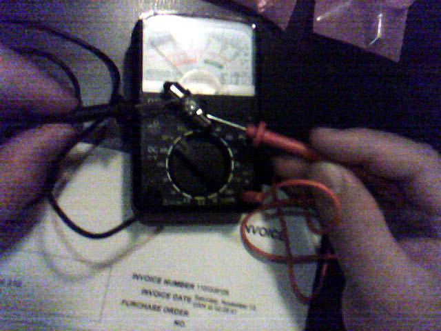

First... i'd like to say sorry for the quality of the picture. I used my camera phone to take it.
Thanks for answering my post too. I'm assuming you mean to test it this way right. I did have it set in the Ohms section.
The needle did not move at all. So that means it's a busted bulb right? Hmmm... even if the bulb is busted... it would and could blow a fuse? But the guy said it shouldn't b drawing more power than the stock OEM's. Perhaps i got the wrong bulb? Well all i know the bulb is a 12V. Should i have bought a 6V? That would draw less current right? Tomorrow i will try and test it out on the OEM version to see what i get.
I assumed you had the digital type multi-meter. You have the old type with a needle.
What happens when you touch the two leads together? The result should be the same as when you touch the two ends of the bulb - if the bulb is good.
I suppose the bulbs could have some kind of internal short circuit that would cause a fuse to blow.
Your car has a 12 volt electrical system, so you should only use 12 volt bulbs. I would assume that a 6 volt bulb would blow as soon as you installed it.
Sorry I can't be more help. I am not familiar with the type bulbs you are attempting to use.
Hahaha, thank you very much for your info.
Yup i am using the old multimeter. When i touch the two leads together, nothing shows up, and according to the Ohms part, it is on "0". So i suppose there is a short somewhere inside it. I'll have to call them and ask them to return it.
