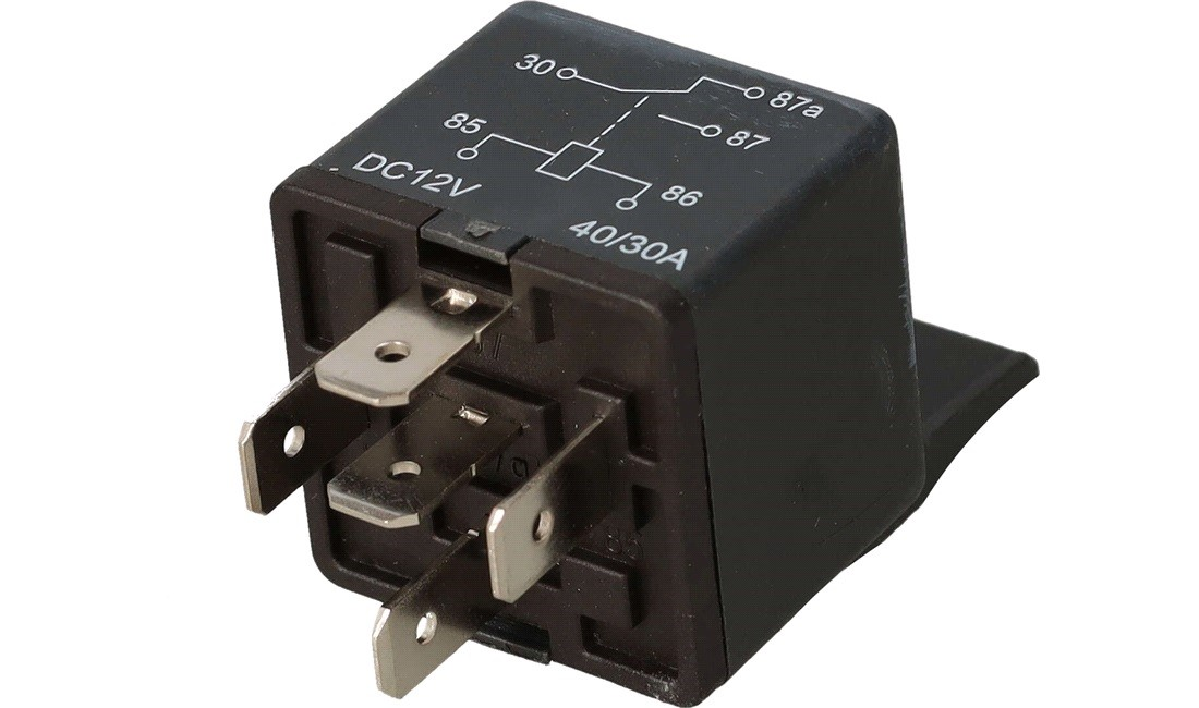

If only problem is the ventilated LED blow fuses it can be handled with a relay:
