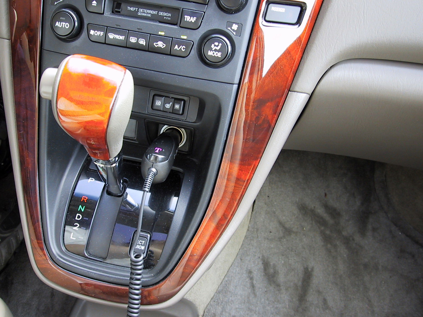

LexKid630 Posted January 22, 2006 Posted January 22, 2006 If you look at this picture you can see it... There's a small black plastic cover an inch or so above the "P" on the center console near the shifter. If you lift this plastic piece off (with a flat head screw driver) you will be able to "push" (i think) something down that will allow you to put it in "N" It's all in the manual.
SKperformance Posted January 22, 2006 Posted January 22, 2006 You pop the cover off with your key and then press you key into the hole beside the shifter.
