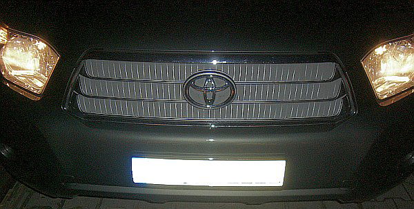

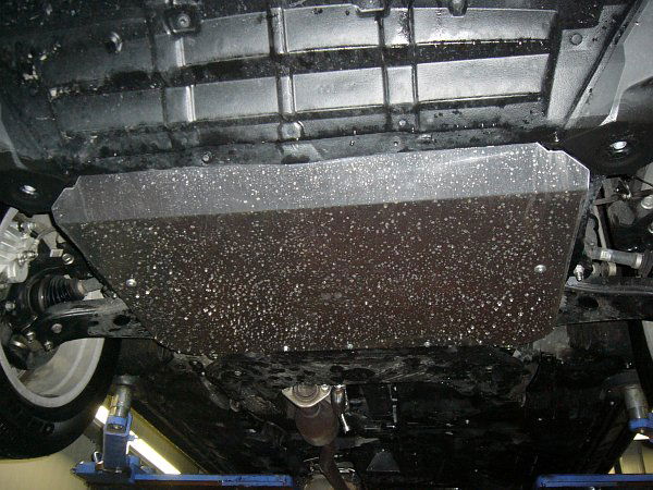

HyBird Posted February 6, 2010 Share Posted February 6, 2010 So, it's been around -10 to -14 (celsius) in my neck of the woods. I notice the 400h takes quite a while to blow decent heat. Hi from Germany, although driving a Highlander Hybrid you probably try to close the hood grill to avoid getting cold air to the cooler. I did that on both my Prius I '2003 and HH'08 without havng problems also on hot days. This will reduce warming up time significantly. Also mounting an underbody aluminum plate keeps engine and oil pan warmer and clean. HyBird Quote Link to comment Share on other sites More sharing options...
