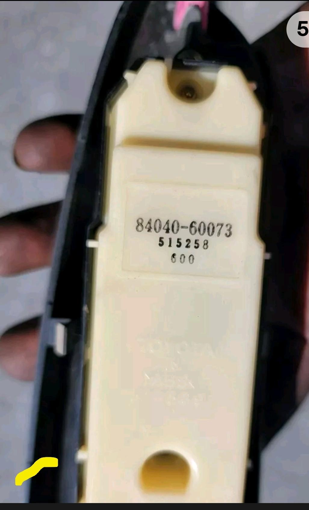

JKSims Posted April 26, 2024 Posted April 26, 2024 My wife's 2007 GX470 was having battery drain issues. I tracked it to the little lights on the power window switch never turning off. I pulled it and it looked like an aftermarket unit. I bought another aftermarket unit and sure enough, I had the same problem. Has anyone had any luck with replacing these with something. Non-OEM? I'm not paying almost $700 for that part from Lexus. 1

Wags470 Posted December 19, 2024 Posted December 19, 2024 (edited) Having the same issue. Really don't want to spend $700 on OEM switch trying to find out whether anybody found an aftermarket part that actually worked. It looks like mine was replaced by the previous owner with an aftermarket switch. Edited December 19, 2024 by Wags470 Spelling error
Wags470 Posted December 19, 2024 Posted December 19, 2024 Just ordered a used OEM unit from eBay. I will post how it works after I install it.
Wags470 Posted December 24, 2024 Posted December 24, 2024 Replaced the switch with a used OEM switch, problem solved no more parasitic drain.
