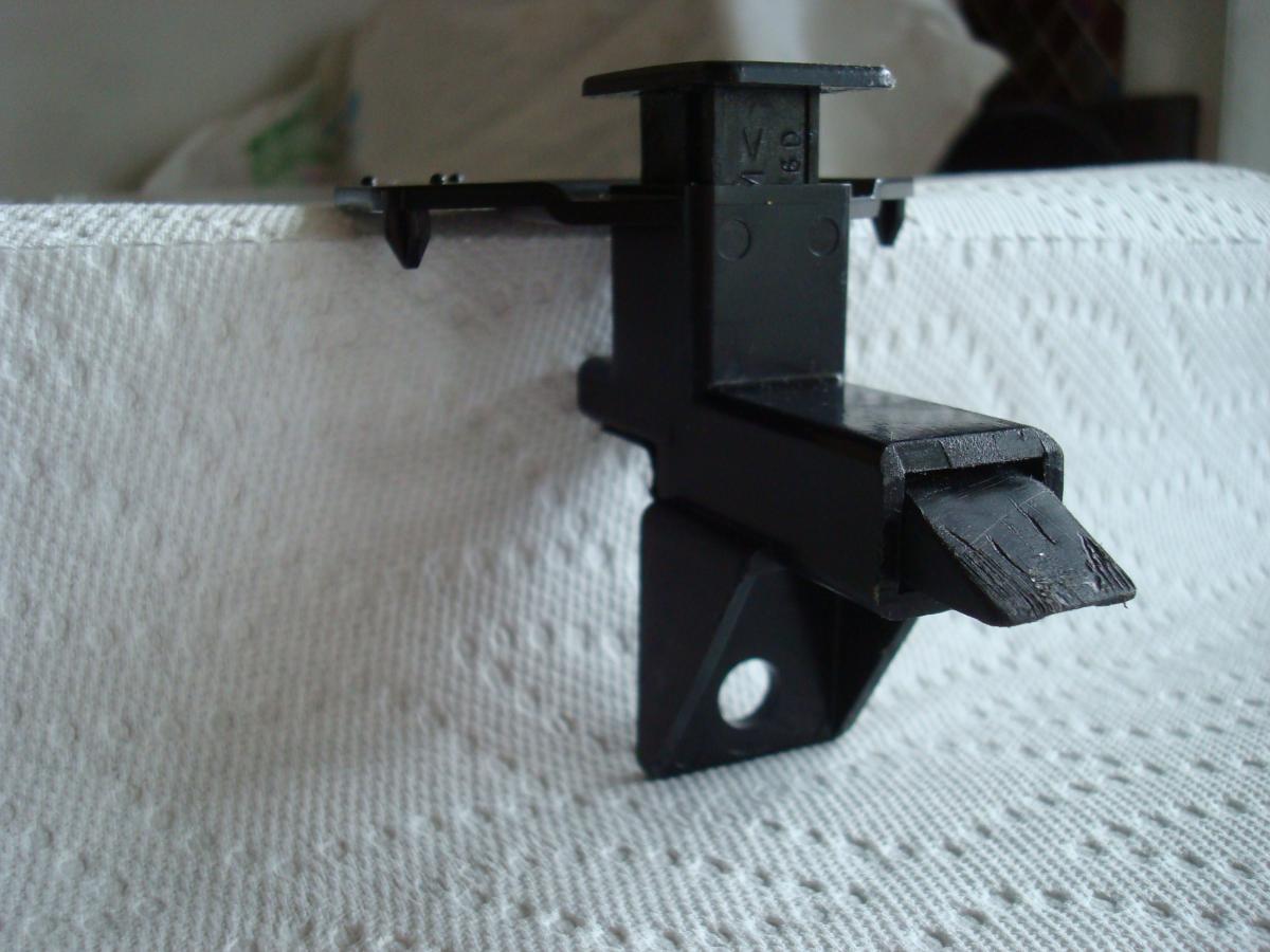

illinik Posted May 2, 2014 Share Posted May 2, 2014 Are the Cargo floor pad latches replaceable and if so, what is the part number? Ours no longer hold the cargo floor down and appear to have something in them that's binding - like may be sand. I've added two pix. The button on top is pushed down to release the latch and lift up the cargo floor. There are two of these in the cargo area. Quote Link to comment Share on other sites More sharing options...
maseace Posted May 2, 2014 Share Posted May 2, 2014 Possibly #22 in this parts diagram? https://www.parts.com/index.cfm?fuseaction=store.sectionDiagram&vehicleID=187488&diagram=8913685 Quote Link to comment Share on other sites More sharing options...

rx350gs300 Posted March 27 Share Posted March 27 (edited) i have the same issue... one of the latches broke somehow...lid wont stay closed ... 2008 rx350 Edited March 27 by rx350gs300 Quote Link to comment Share on other sites More sharing options...
rx350gs300 Posted March 27 Share Posted March 27 search for LEXUS RX350 Lock Sub-Assy Deck Board 58405-48010 Quote Link to comment Share on other sites More sharing options...
