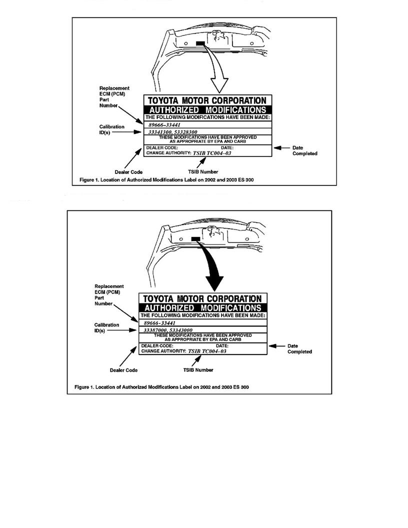

The flash appears to mainly deal with up shifts. I am not sure if it would affect the downshifts, but are you sure that the car has been flashed? look under the hood for a sticker, it will indicate if it indeed has been flashed. I have attached a copy of both of the two possible ecm flashes.
Hi - thanks for responding. It has not been flashed as there is no sticker, so I am optimistic that it will help. My only hesitation is if the RPM on the first couple gears will seem strange, but I would think Lexus wouldn't have released this if it wasn't a reasonable fix. Any input would be great.
