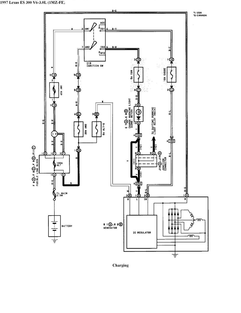

This is the schematic for your car. What type of test did they perform before telling you the diodes are bad? While this is possible, it is not likely. First you would want to check the alternator warning light, this is much more than just a indicator bulb. The 12v signal that comes thru the bulb supplies the feedback to the regulator. If the bulb burns out, the alternator will not generate any current. There are also several other fuses that you should check before condeming the alternator. But there is a very high possibility that the bulb is burned out, and that is the only problem.

Ok, When I saw the no battery light, That made me concerned. I would recomend checking the fuses associated with the alternator, and then replacing it.
