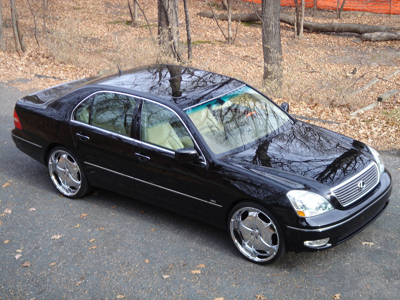

scottp Posted December 29, 2006 Posted December 29, 2006 I put 22" wheels/tires on my 2006 LS430 and they are SLIGHTLY hitting over large bumps...does anyone have history/solution here?
92Lex Posted December 29, 2006 Posted December 29, 2006 22's?!? Damn, you're brave. Is it rubbing the fenders or inside wheel liner?
scottp Posted December 29, 2006 Author Posted December 29, 2006 22's?!? Damn, you're brave. Is it rubbing the fenders or inside wheel liner? hitting the bolt that holds the liner onto the fender...the wheel guy tells me a body shop will "roll" the fenders and i will never even know it is done?
92Lex Posted December 29, 2006 Posted December 29, 2006 Yes, you should have your fenders rolled. The tool basically flattens the inner lip of your fender. Make sure that they use a heat gun to "soften" the paint prior to rolling the fenders. The paint will most likely crack if it isn't heated. Or you could just do it yourself at home with a baseball bat and a heat gun.

chino904 Posted March 25, 2008 Posted March 25, 2008 I put 22" wheels/tires on my 2006 LS430 and they are SLIGHTLY hitting over large bumps...does anyone have history/solution here? i just put 22" on mine and had the same problem. Putting a size 235 /30/22 toyo prox tire helped me out. let me know if it works for you ill post a picture so you can see. Chino
ferraribuysell Posted March 25, 2008 Posted March 25, 2008 I have 22" wheels on my LS430 and I just banged the metal where it rubbed. It barely rubbed at all but noticed a few wear marks on the plastic wheel well and banged on them with a hammer. Fixed it. I think theres a pic of my car on here.
