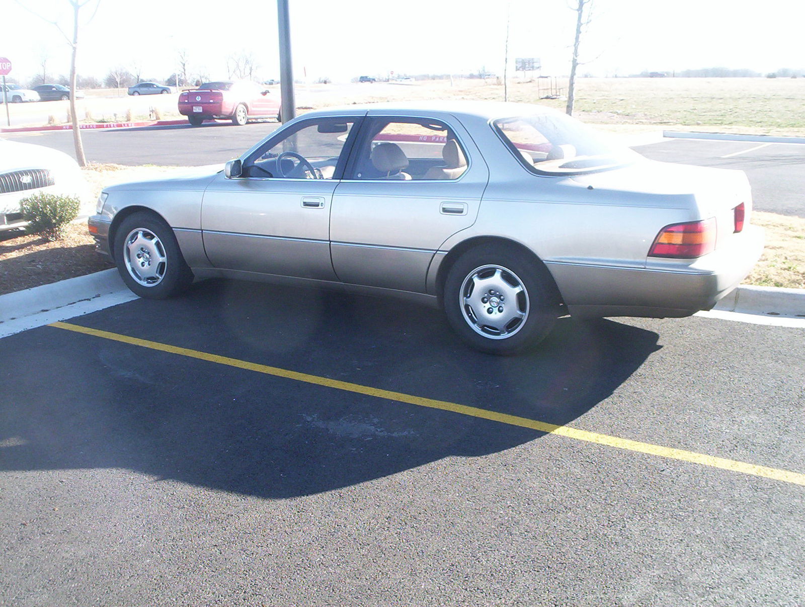

SK, my current wheels are stock for my '93. The lugs don't look that great and the new wheels don't have a center cap that covers the lugs.
I've never been to the dealer for various reasons but mainly because the nearest one is an hour and a half away.
I've looked on ebay for lug nuts and know that it is a shank style but I am seeing two different lengths. I may call Sewell Lexus (they're pretty close) and try to describe the wheel to the parts guy and see if he can help me.

I just replaced the lug nuts on my '93 as well. I picked some up from Manny, Moe, & Jack for $30 for 5 sets of 4 nuts (they didn't come in sets of 5 which you'll need). I opted for the non-locking type, but you can find aftermarket ones w/ locks.
I think that you'll want 12mm x 1.5. You want the ones that have the washer on them and NOT the tapered style. Make sure you don't get the long shaft though or they won't secure the wheels properly. I made that mistake and had to return them.

SK - From my experience I would say that he'll need the correct length shank.
I tried the longer shank on my new wheels. What ended up happening is that the longer shank made contact w/ the hub and was tight to the hub, but it did not bring the wheel completely tight against the hub. There was a gap between the washer on the nut and the wheel (about 3 washer thicknesses). Had I installed all of the nuts on a wheel, the wheel would have been loose with some play in it.
Ordered the short shank from toyotapartsonline. Called him and he said that he would throw in 5 long ones just to see which ones work.
He said that he thought it depended more on the wheel than the car, but wasn't sure. I'll let you guys know this weekend.

Well got one of the wheels in today. Need 3 more lets just hope they got seperated in shipping. Also received my lug nuts that I ordered.
SK was right that they are basically the same nut one just has a taller "head". And both will work on these wheels. However the long shank are the only ones that will look right. The short ones are sunk way into the wheel and do not look the part.
So for anyone that swaps later model wheels onto the 1st Gen LS the long shank lug nuts are the way to go.
