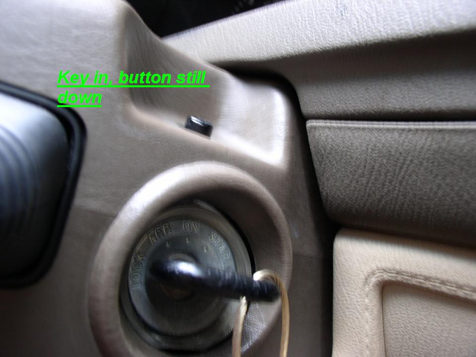

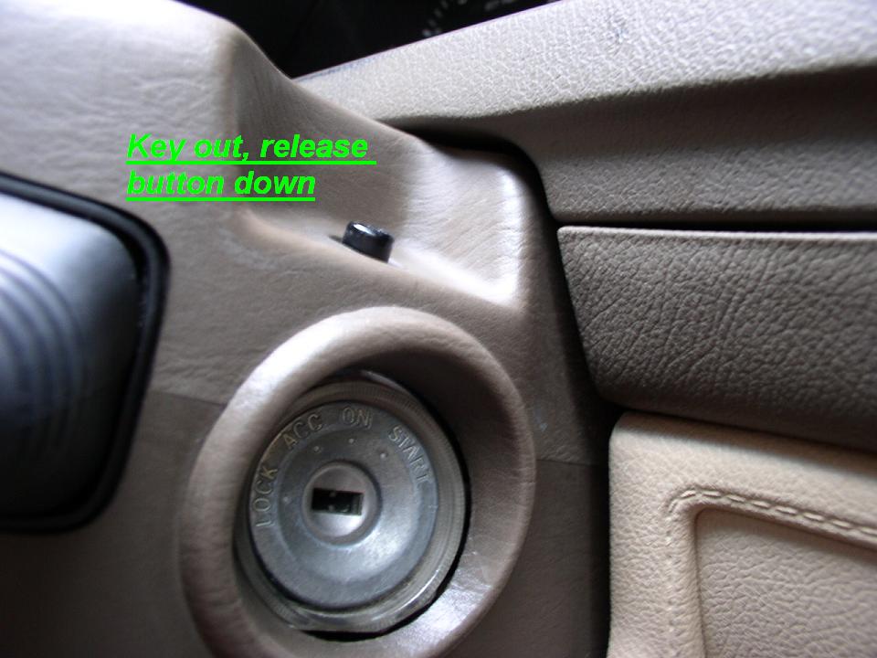

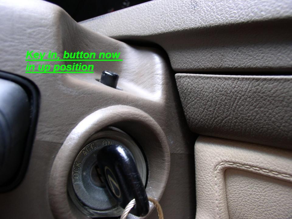

91L3xus Posted July 29, 2005 Posted July 29, 2005 This has happened on my car also. Try pressing the key release button above the ingnition switch and inserting the key in at the same time. Or try pressing the button a few times before inserting the key. If the button does not pop up when you insert the key, then it's stuck and you might need a new ignition.
