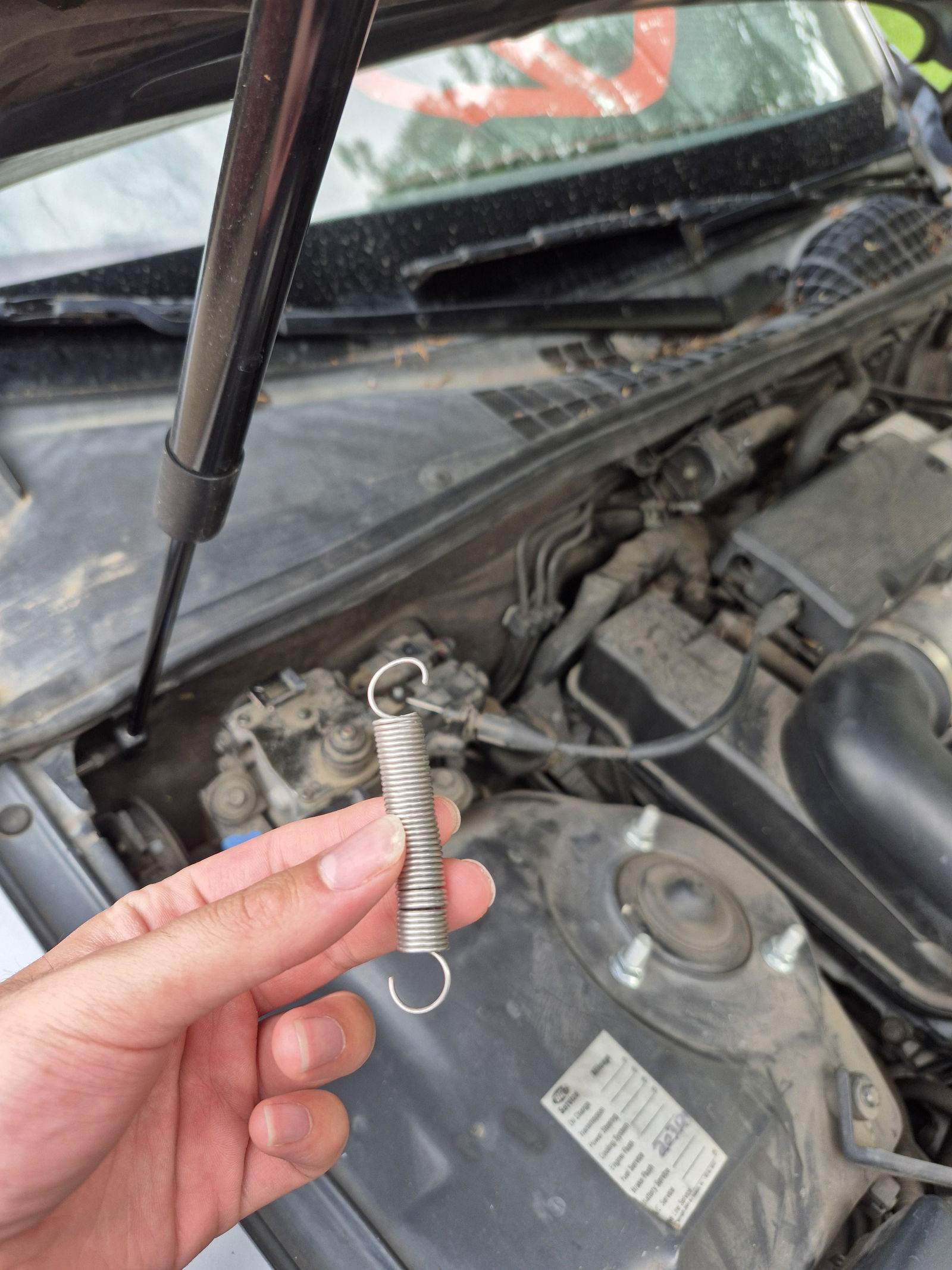

jp6296873 Posted July 2 Author Posted July 2 On 6/28/2025 at 2:59 PM, RX400h06 said: Did you call the previous owner to ask if he experienced the issue, previously? If you are not an experienced auto troubleshooter, I would recommend taking the car to shop that specializes in no start or stall issues. My son had a battery drain issue, so he took it to a local shop that is well known for troubleshooting difficult-to-resolve issues. The culprit turned out to be the alarm system - something they have dealt with and resolved in the past. On 6/27/2025 at 3:36 PM, Jeremy M. said: Ah. Yeah, with it being able to rev, you should still have spark, so CPS is less likely. Checking fuel pressure definitely wouldn't be a bad idea. If it's low, I'd recommend finding out if your car has an external fuel pump, and if so, replacing it and re-checking the pressure. I contacted the previous owner asking if he's had this issue. He said he's dealt with the same issue sometimes. All he told me was "There's a cable with a spring under a cover near the passenger firewall". I remember before the issue started, I removed the cruise control cover and a spring suddenly came out. I wasn't sure where the spring belonged so I put it away. A little bit after that is when the issue started. Not sure if I somehow messed with some kind of idle/throttle cable spring and that's why the car won't idle. Here's a picture of the spring that came out when I had removed the cover for the cruise control.
Jeremy M. Posted July 2 Posted July 2 That spring certainly isn't from the factory. Does the owner have any information about where the spring was installed? Also, what cover are you referring to as the "cruise control cover"? Would you be able to take a photo of it?

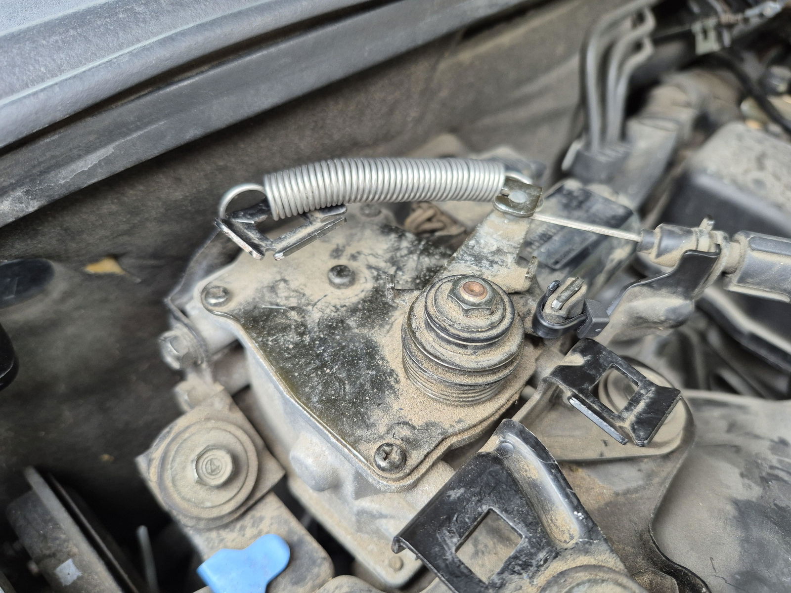

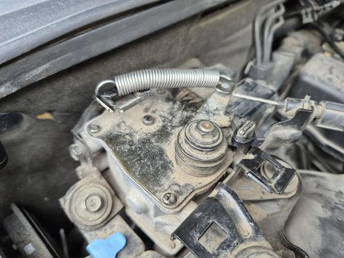

jp6296873 Posted July 3 Author Posted July 3 21 hours ago, Jeremy M. said: That spring certainly isn't from the factory. Does the owner have any information about where the spring was installed? Also, what cover are you referring to as the "cruise control cover"? Would you be able to take a photo of it? It seems that the problem has been solved. I told my neighbor about what the previous owner had told me. It seems theprevious owner had this spring hooked onto the cable that goes from the throttle body to cruise control actuator, which apparently has a part in controlling the car's idle. When the spring fell out, the cable had nothing pulling on it, which is why the car wouldn't idle. Here is a picture of how it's been left. Now I need to find out why I can't get the shifter to move, unless I press the shift lock override button. Thank you for the help.
