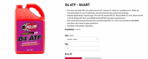

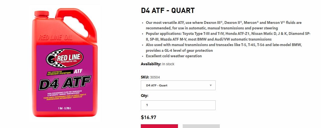

Hadyourphil Posted July 7 Author Posted July 7 In an effort to thoroughly confuse the reader (and the author of this thread), I see where the recommended fluid goes by three names: T-IV, JWS3309, and NWS6500. The website for the pricey Red Line fluid shows the names of the last two but not the T-IV. What, if any, are the differences? How important are they? I've owned two RX-300s that both died by transmission failure so I really would like to avoid a third time. And, if draining and filling only results in a portion of the fluid being changed, how often should this be done?
McBrian Posted July 7 Posted July 7 The general on the ground consensus is every two years a drain and fill (or if you have a vacuum pump you don't have to go under) and at least once in its life (or every 100k?) for a full pan-off filter/gasket service. If you have no idea when or if it was ever done, do the big job and reset the clock (and your nerves.) The Valvoline stuff will read Toyota/Lexus T or actually include T-IV. Never seen those other numbers. Can't remember if it was a Blue or Silver jug.
Hadyourphil Posted July 7 Author Posted July 7 The two numbers are mentioned in the '01 owner's manual on page 274. Also they show up in the Red Line website in a long list of fluid names. It would be interesting to see what they mean and what difference they make.
