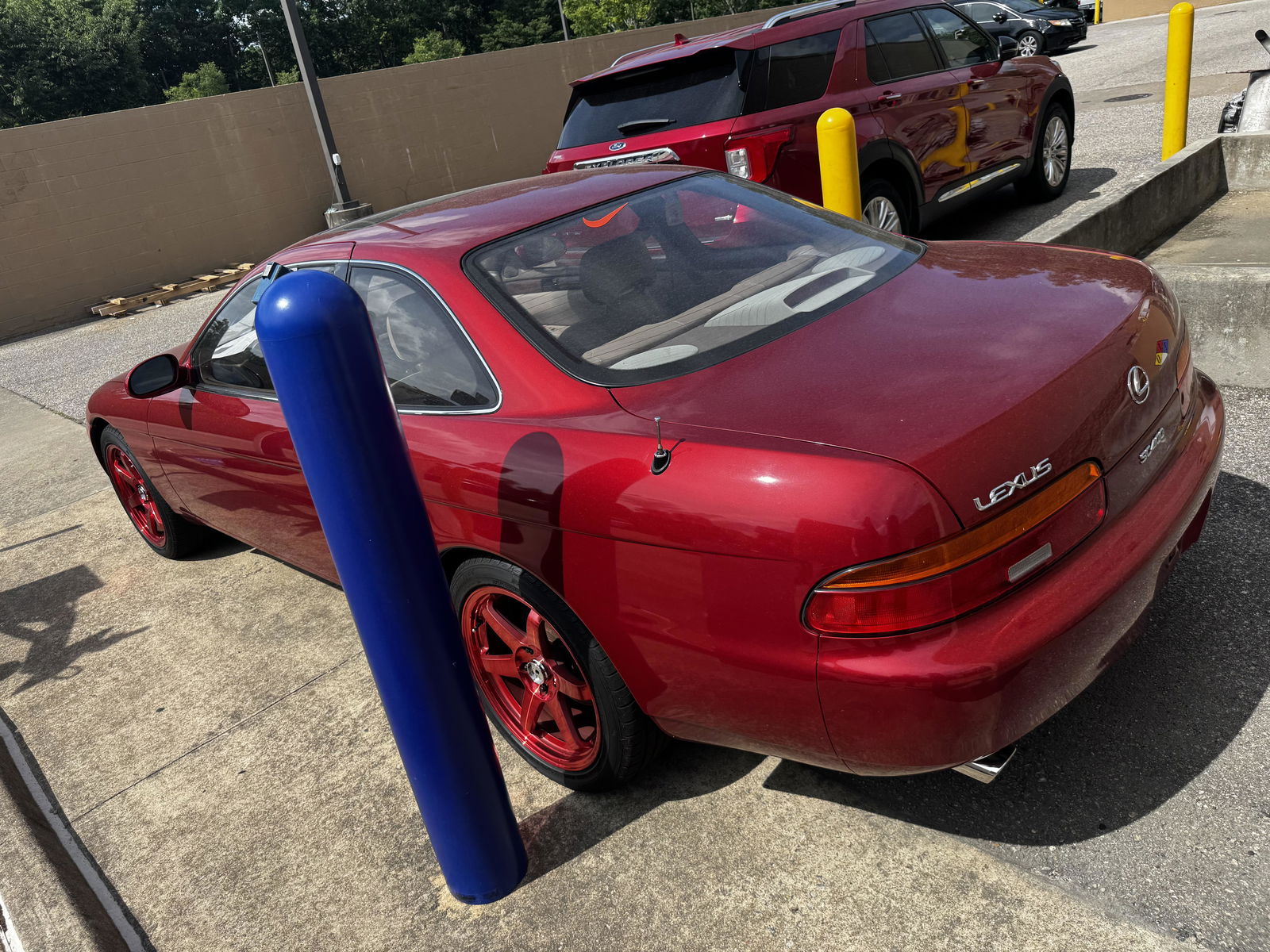

Greetings all. I am a new member and will be picking up my first SC this week. It’s a 1992 SC400 with 67k miles. Red over gray. When I get her home I will post pics. One thing that will need attention quickly is replacing the wheels. I’m not a fan of the aftermarket’s that are on it. I don’t mind them being a 5 spoke but I’m not a fan of the red color. I’m sure I will have a ton of questions so TIA!
So any thoughts on putting 2014 IS250 F sport wheels on the SC? 18s and the offset looks like +45. Everything in reading says these are 18x8 front and 18x8.5 rear. The tires are slightly smaller diameter by .3 inches until I would wear through them. They have the stock 225/40 front and 255/35 rear where tire rack recommends 245/40 front and 265/35 rear. I just have someone local that has these and would trade for these red aftermarket wheels currently on the car.
