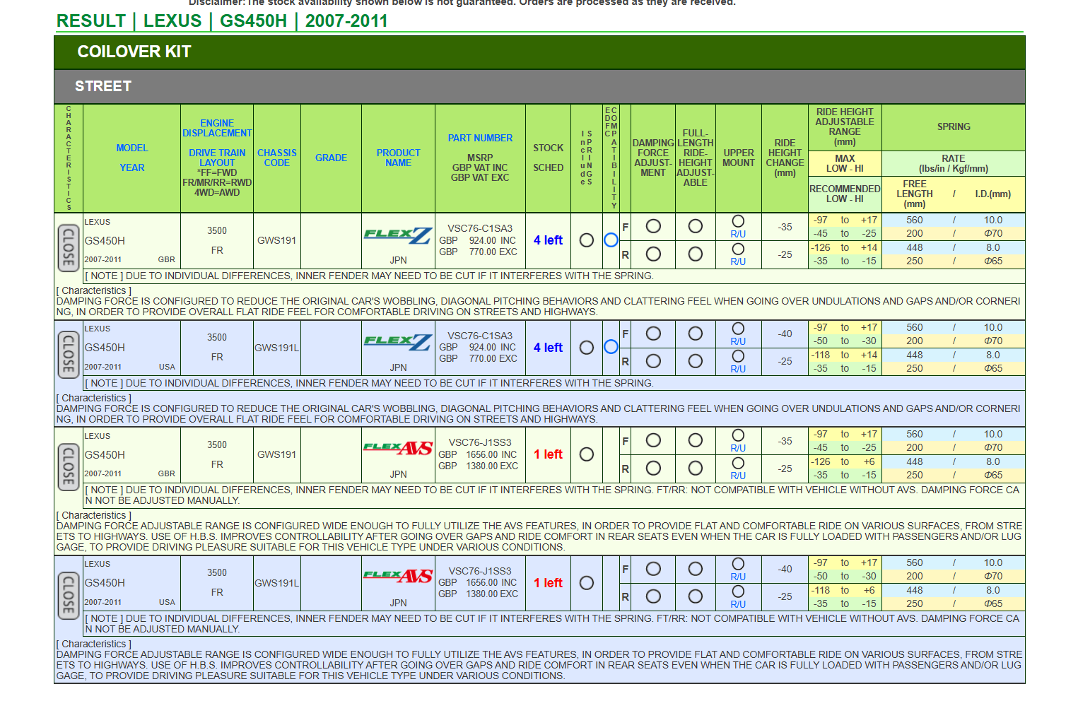

Don't completely dismiss the coil overs idea. I'm not at all a car modding guy. Never messed with suspension in my life. And as I say, I was wary of the Tein kit fitted to mine but it rides really well. Very Lexus-like and not at all firm or crashy.
This is what I found but I am not sure what im looking at aha but what you said sounds good to me

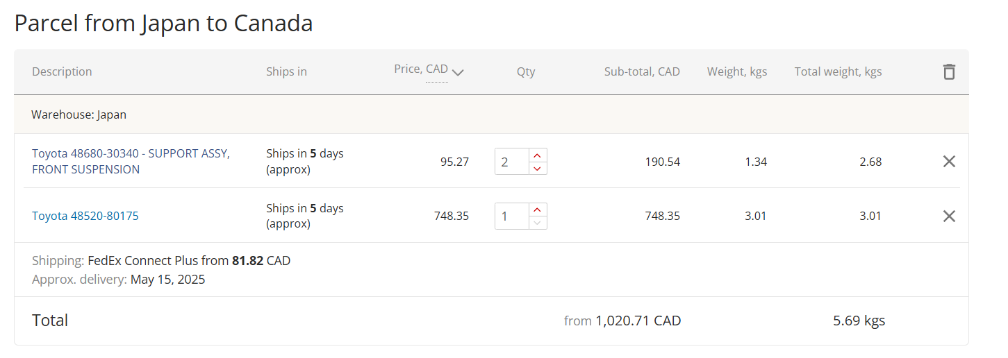

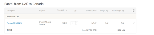

I have actually found OEM Toyota parts from Partsouq.com
I checked around to see how reliable they are and have seen nothing but good comments, TrustPilot says the same story
Check image for prices. This is just for the front right side, OEM w/ Adaptive Suspension. (left was not available right now)

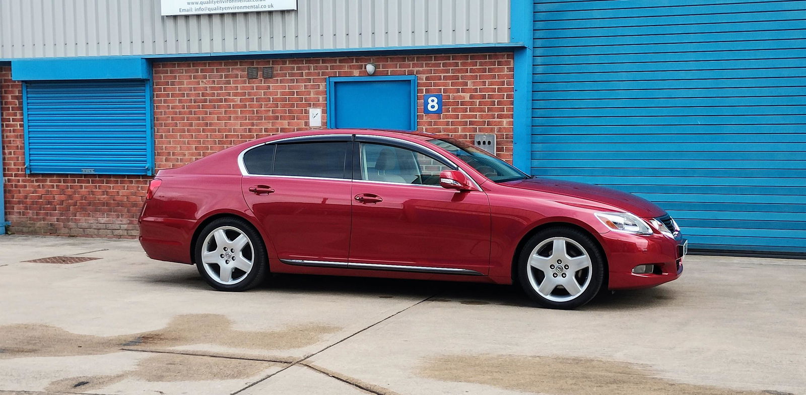

Mine sits a bit lower than standard. It also has LS430 5 spoke wheels on because I'd imagine the originals corroded. Unfortunately they're a tiny bit narrower than the standard wheels and this necessitated spacers to get over the huge calipers. Normally I wouldn't entertain the idea of a car modified by someone else but it seems to have been done out of necessity more than anything else. The previous owner was in his 70s, no boy racer! I think the look suits it and as I said, it rides very well. I've never driven a standard GS 450h and I might notice a difference if I did but to me it's just fine.
No lights or effect on traction/stability control.

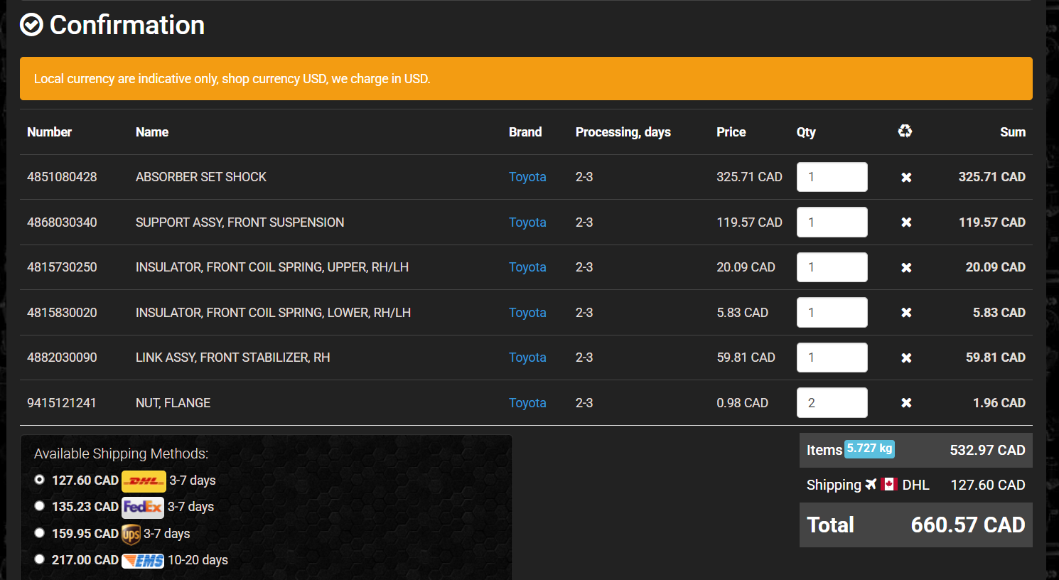

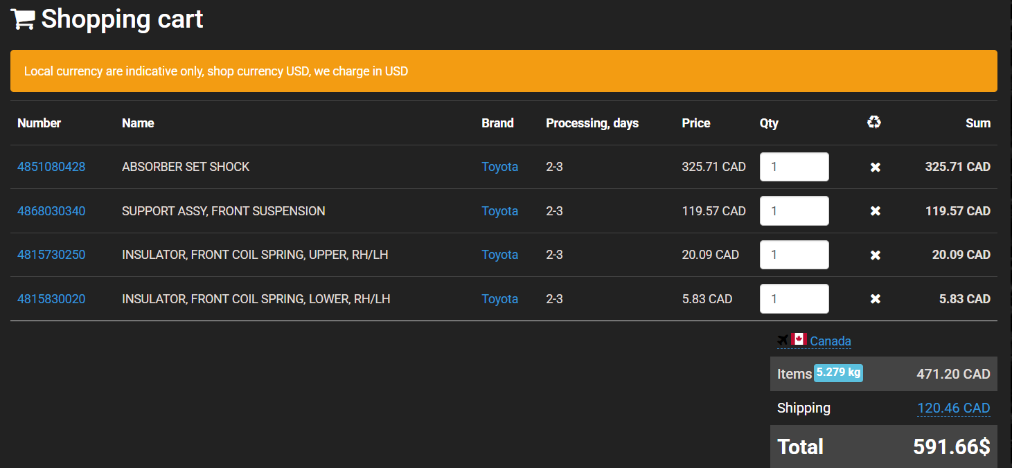

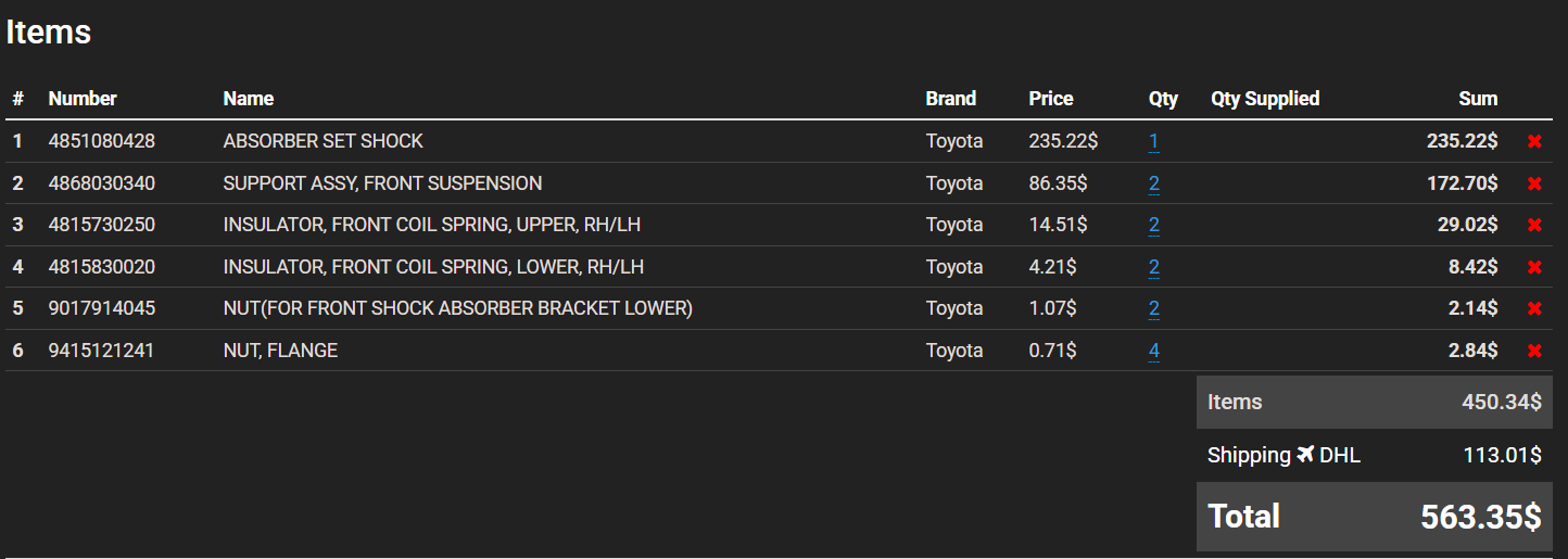

Small Update*
Just ordered the parts for everything on a front shock replacement other than the left strut (looking for one available a decent price) and the coils (my car only has 184,000kms and the coils should be great)
The links for the front can be ordered by any garage at a normal price so that will get done when I bring the car in for the work
I will drop a pic of the total, keep in mind it is in USD (Converted to CAD for me by my bank upon transaction so rates may vary)
original_f44b4fc8-e3cf-474c-baf2-5ef02893dafa_IMG_20250419_110559097.thumb.jpg.6850ec2b8fc4fe25cd00a47c2f5c87fa.jpg
That looks great! I really do like the height and the color! Unfortunately for me, our roads are horrendous.. potholes the size of bomb craters. This makes the lower height hard to ride around with over here 😞
