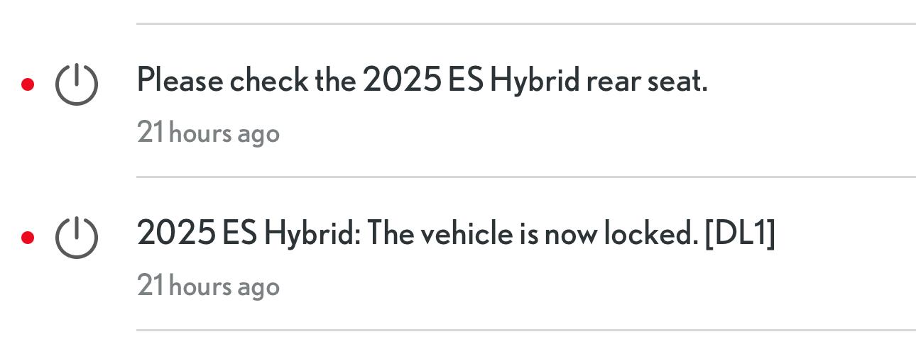

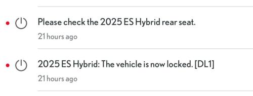

I can’t turn the rear seat reminder off, In the on screen display it shows off under vehicle settings yet I still get a notification in app to check the rear seats after locking car.
Anyone else seeing this or know how to stop it?

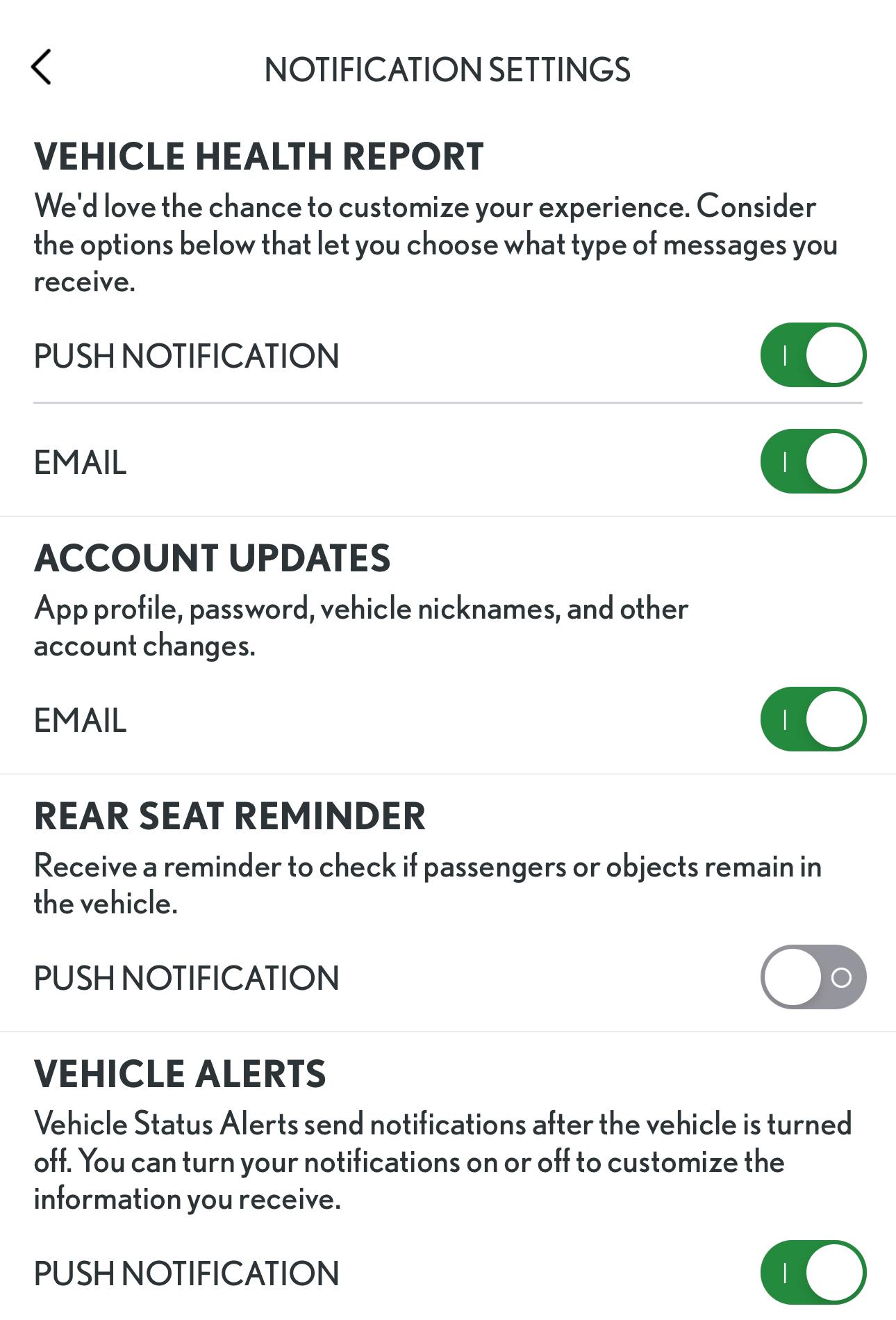

Aha! Didn’t even think check app settings since it’s turned off in car settings. But sure enough under Account Settings>Notification Settings, Rear Seat Reminder, Push Notification was on (default setting).
Thanks for the answer!
