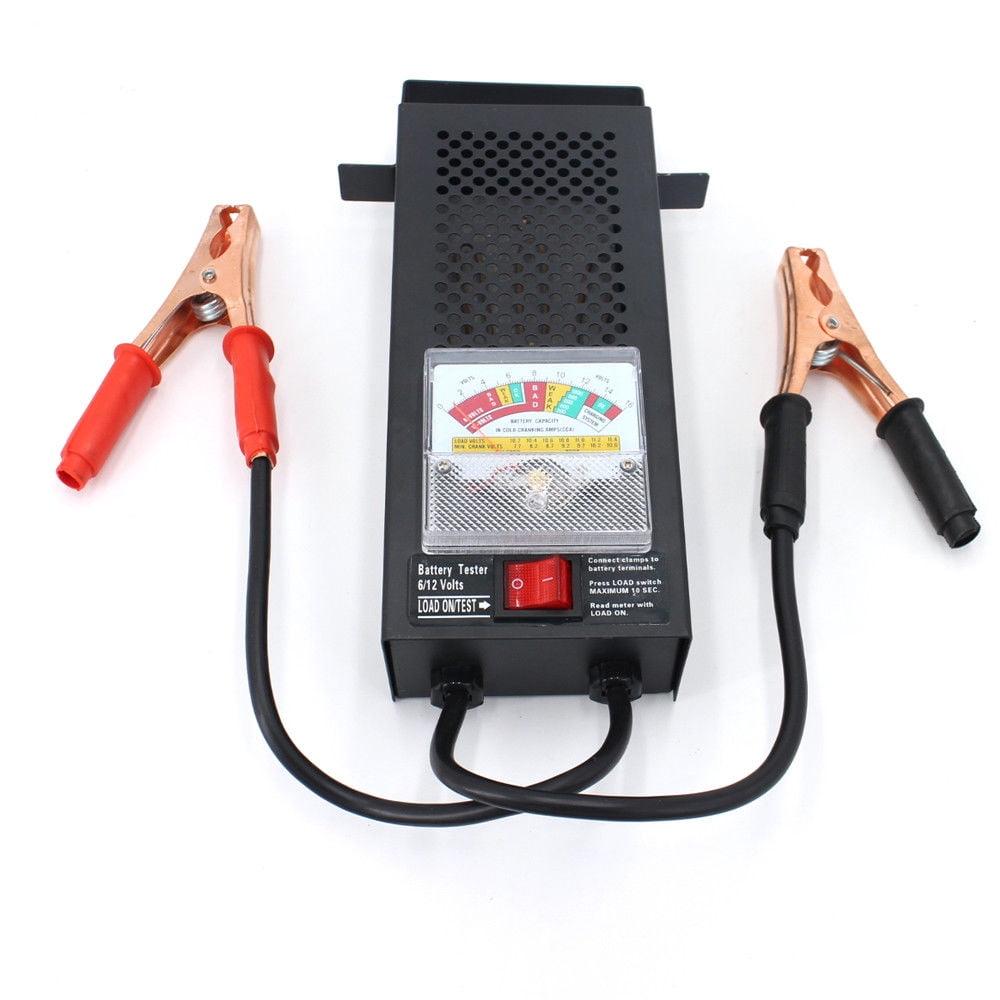

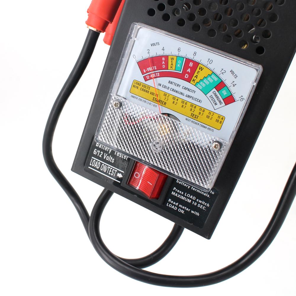

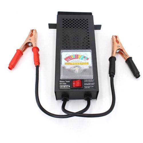

Either your battery is weak or you have grounds that need to be removed, cleaned and put back on. Check the resting battery voltage, should be 12.4 V or higher. Clean the posts, connectors and cables. Put it on a charger, top it off, remove charger, test after 1 hour and 12 hours to see if it holds the charge. Other option is to use a waffle battery tester on it. Can buy them for $20. The new digital meters the auto parts stores use are useless, often show battery is good when it isn't.
