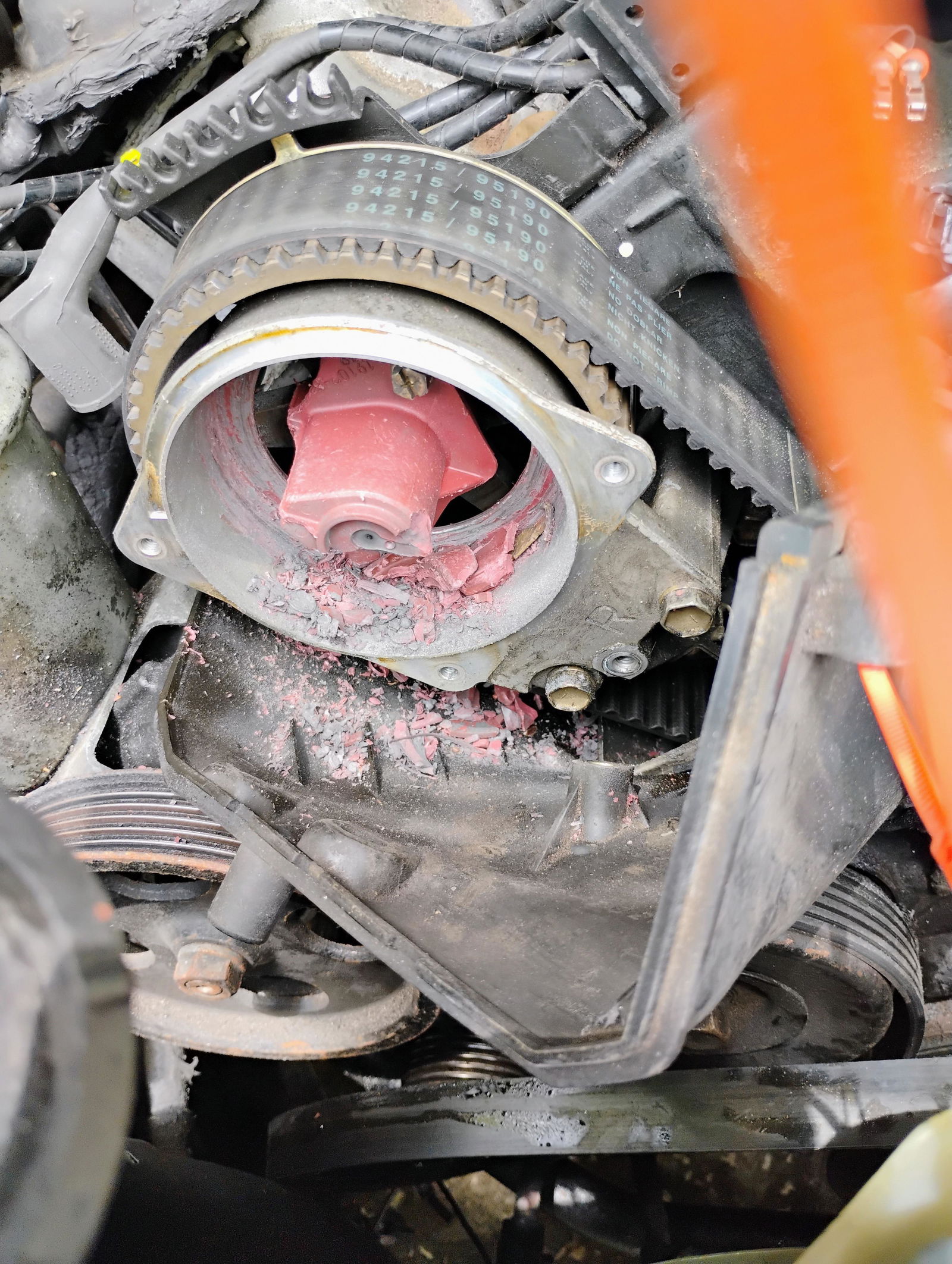

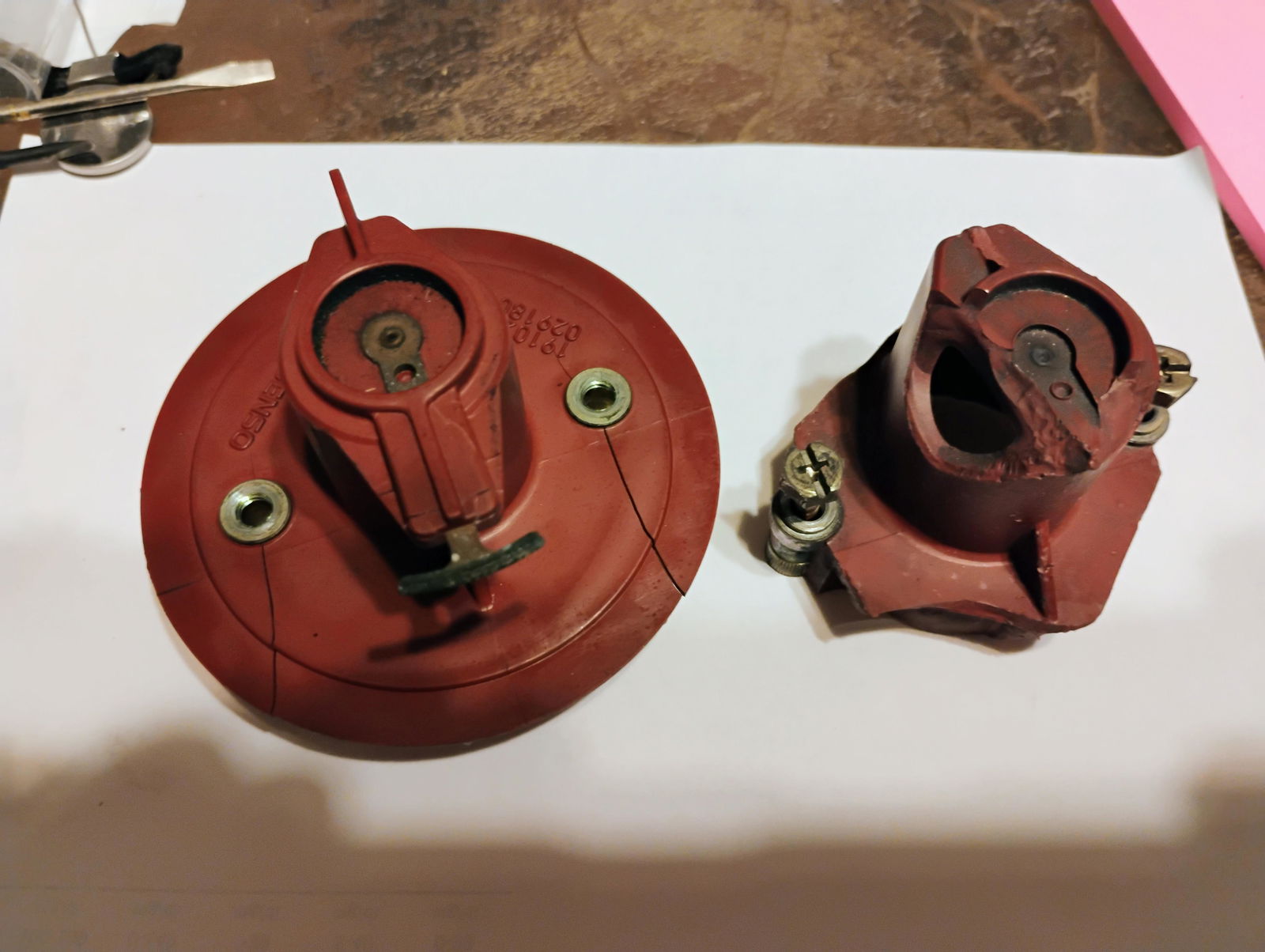

threepwood Posted Wednesday at 09:52 PM Author Posted Wednesday at 09:52 PM Well, I haven't finished putting it all back together yet, but I do believe (although I find it unbelieable) I have finally found the real problem. First I pulled the drivers side distributor cap and found the rotor worn and cracked. But certainly not bad enough to explain this. I replaced it anyway because of the cracks radiating from the screws. Restarted car, no change. Then I decided in bed one night to ground the high tension coils of each distributor individually and try and start the car, To my surprise, after grounding the drivers side the car would NOT start, period. But grounding the passenger side had no effect, car started and ran poorly just the same as if it was connected. So I tear into the passenger side distributor and find the rotor completely disintegrated. See pictures. Is this a known issue? I can only guess that the last mechanic overtightened the screws, they both cracked and the one just eventually came completely apart. The qurestion now is how many of the timing belt covers do I really need to remove to get all the debri out ? I'm thinking I really should remove the bottom timing belt cover as the steel top pin is still missing!
