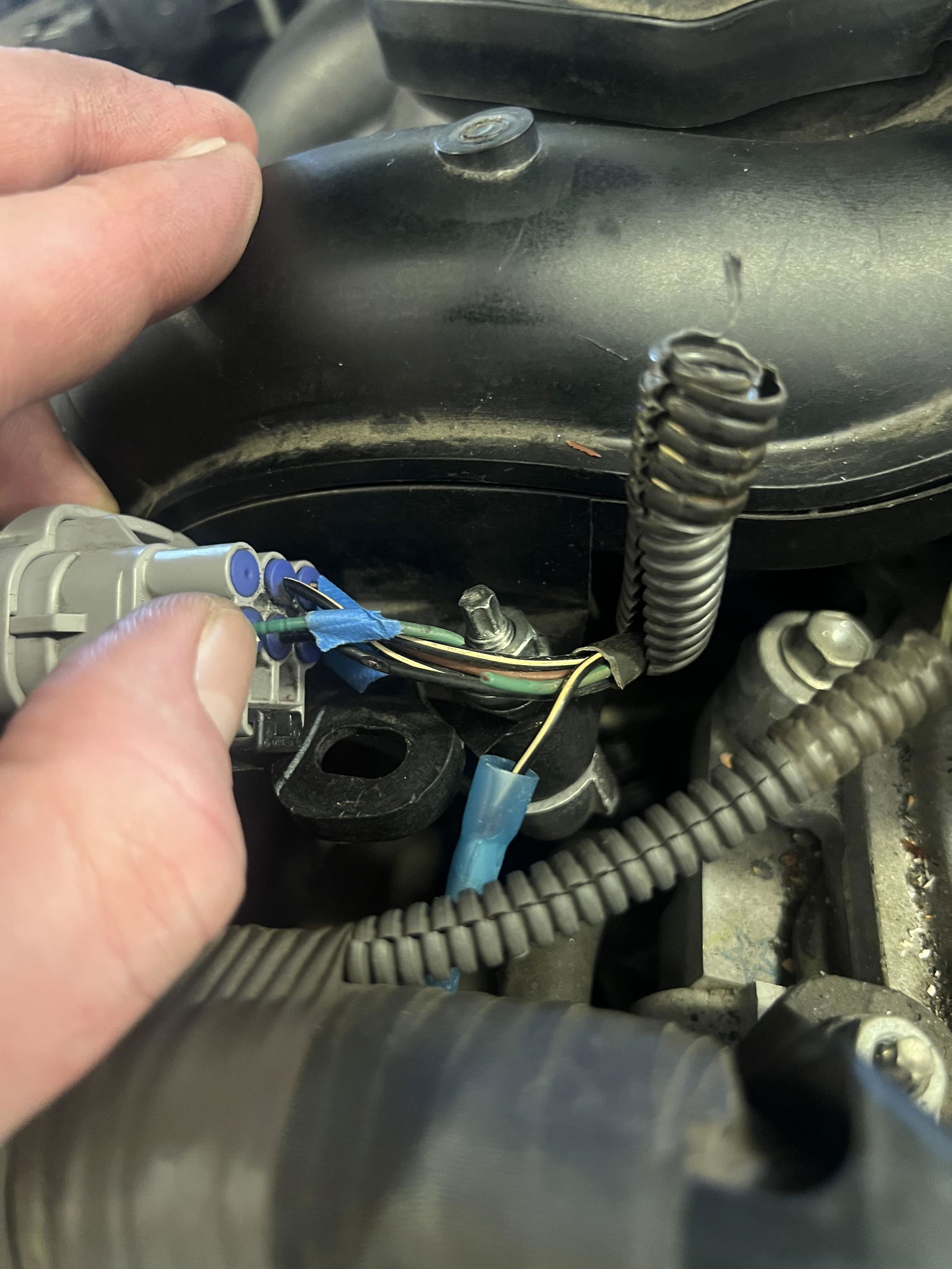

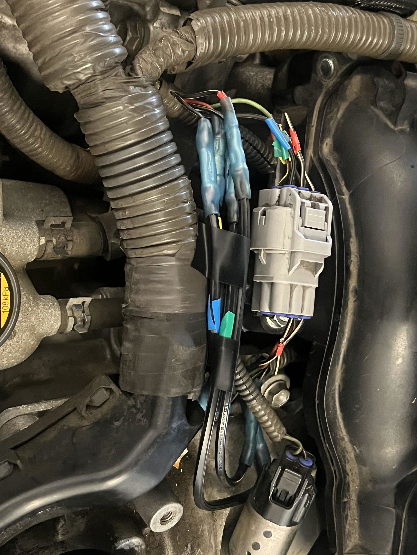

I took that thing apart like 6 times but finally figured it out. It was a 6 way housing connector that lead into cylinder 2,4 and 6. Four of the wires didnt have continuity so i crimped the four bad ones and it runs better than before!聽
