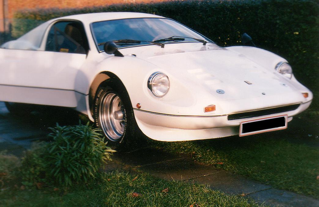

Lexus-CT Posted March 20 Posted March 20 I had a kit-car with 10" rear wheels with 245 tyres on them. Tricky to put them on but with the right tools OK. 1
