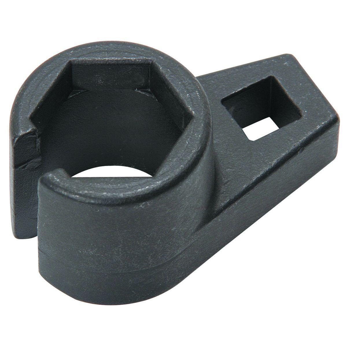

The socket/wrench size is a 22mm or 7/8", and there's cheap oxygen sensor sockets available at most parts stores (one pictured below). Use some penetrating oil and if you have one, a thread chaser to clean the threads before reassembly. Also, make sure not to cheap out on oxygen sensors (especially the upstream ones, they control the air/fuel ratio and as such, how the engine runs). I'd recommend NTK or Denso brand sensors.
